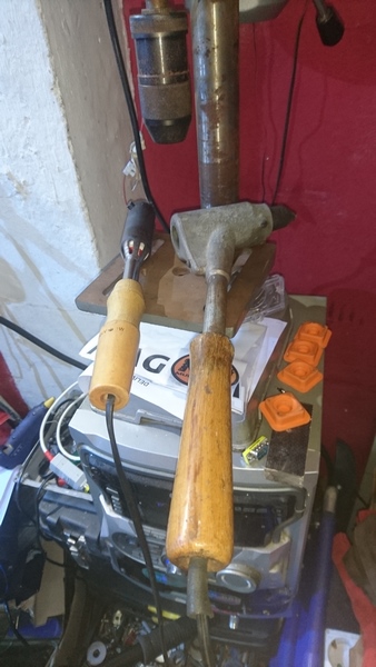

In my case I chose to weld a 0.30mm copper plate, because the hole is so fair that the screws would take away space.
For soldering in aluminum I used a flux:
http://www.ebay.es/itm/282392947581?_tr ... EBIDX%3AIT
And a good 350w welder.
The heat was not a problem for the battery, the welding is fast and the separation between the sheet and the cells is sufficient.
Once modified and with an insulation of 1mm of fiberglass epoxy are left at 75.5mm, that is 4mm of margin to enter the warehouse.
